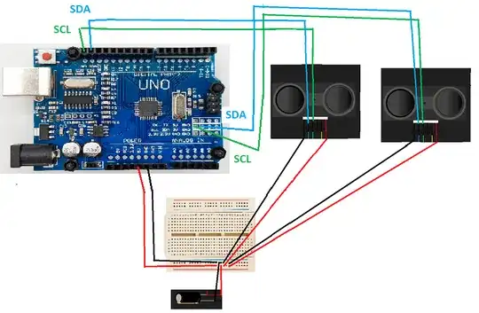

I'm using this connection wire: The photo of the Arduino doesn't show the SCL and SDA pins, but please consider that it has 2 SCL pins and 2 SDA pins in the places where I marked them in the image.
Both sensors are working, however they are mirroring each other's measurements.

If these are the Garmin Lidar Lite V3, here is a link to their data sheet. On page 5 of the datasheet you'll find instructions for configuring their I2C addresses. If you haven't already done that, it's quite likely that both devices are replying at once to the same query.
If you have done that already, please update your question with that and any other relevant data - such as the manufacturer, if I got that wrong, add any configuration changes you've made.
