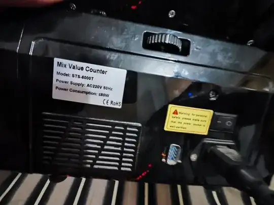

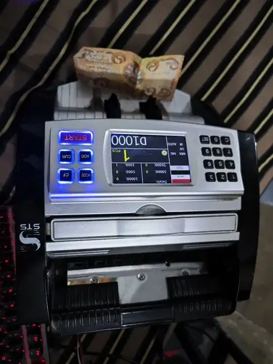

I have cash counter with RS232 in the back of it. I want to read the data that supposed displayed on the projector with RS232 to TTL convertor and arduino.
Here is all my setup

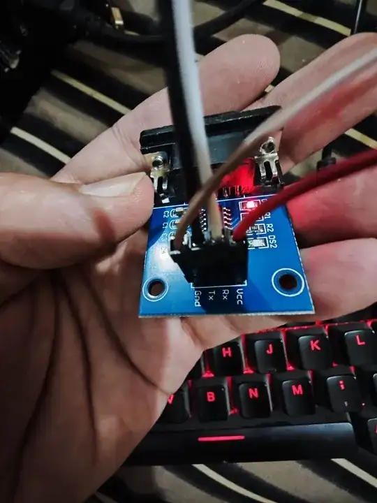

  • Connect the MAX3232 TX pin to the RX Arduino pin
  • and Connect the MAX3232 RX pin to the TX Arduino pin
  • and the Vcc to 5V
  • and MAX3232 GND to arduino GND
  • and plug the MAX3232 to the cash counter and the arduino to the pc

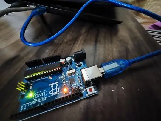

  • and flash
  Serial.begin(9600);
void loop() { int data = Serial.read(); if (data != -1) { Serial.println(data); } }
