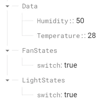

Here is the screenshot of my Firebase for better understanding:
Temporarily, I am using dummy data for the temperature and humidity. Please if you guys know how to fix it, let me know. it will mean so much to me.
