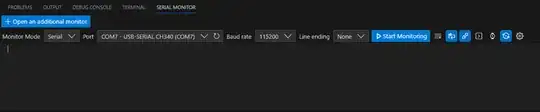

However, it connects to the serial via the Terminal which means I can't send commands like I do with the serial monitor:
If I connect the serial monitor manually. It does not automatically disconnect so that it can do the upload.
How can I set up vs code with platform io to build, upload, and reconnect the serial monitor with a single hotkey?
