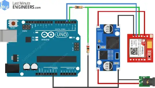

My SIM800L doesn't respond to AT commands. The serial monitor is simply blank.
And the led blinks every 3 seconds which means it is connected to a network
I power it through an LM2596 buck down converter with 4.0 v (I've tried to power with voltages until 4.4v), From a 12v power supply.
Can you help me? (Please keep in mind that I'm an absolute beginner in this field. Thanks)
I used this wiring diagram from Last Minute Engineers. my circuit diagram
And also their code:
