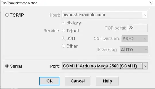

In TeraTerm the local echo is off by default. So you won't see anything while you type something. Here are the settings:
  1. First connect to the serial port.

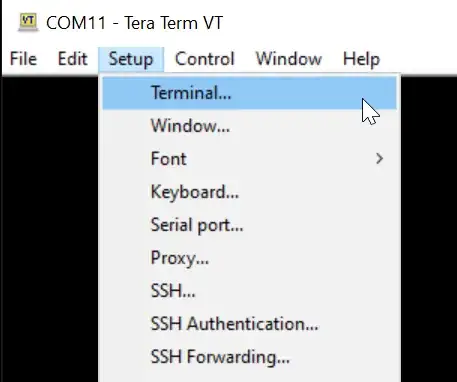

  1. Then go to Setup->Terminal.
  1. Based on your code select what you are expecting to receive at the end of a transmission from Arduino and what you need to send at the end of your command to Arduino to tell it is the end of the command. Usually, it can be Carriage Return (CR: 0x0D) or Line Feed (LF: 0x13), or both.
Also, check Local echo. That will print whatever you are typing on the terminal.

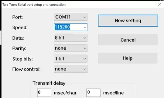

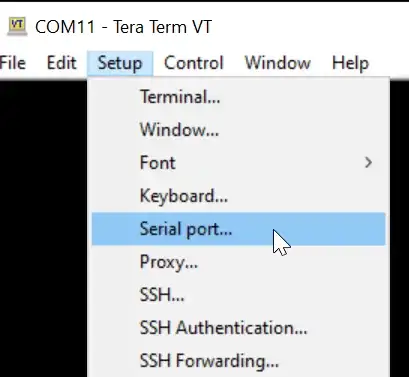

  1. Then Setup->Serial port....
  1. And configure your serial port accordingly.
