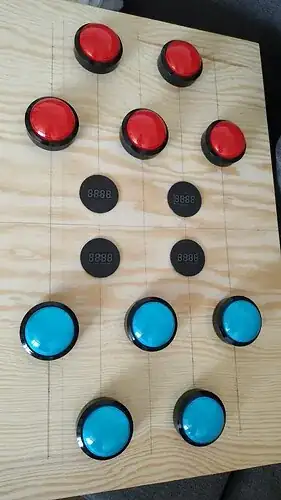

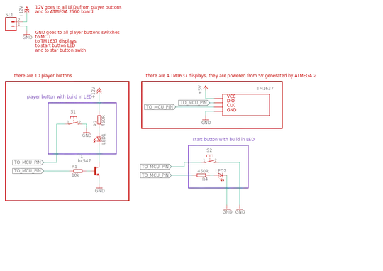

I am building arcade game with 10 player buttons (5 for each player) and one start button. All buttons have build in LED inside. Player buttons has LED for 12V and start button has led for 5V. I am using ATMEGA2560 pro boar. I have also 4 TM1637 displays (two for each player) showing time and score. I am using 12V adapter. This is my schematic:
schematics

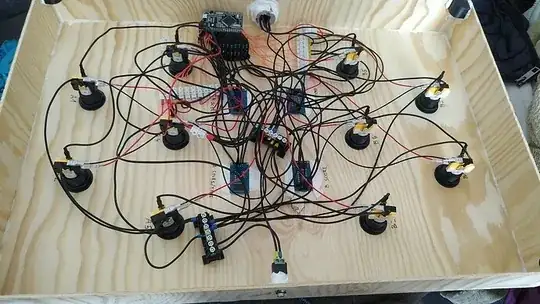

And this is what it looks like inside:
arcade box inside
arcade box front
The problem is ATMEGA2560 just burned. I was testing it firstly without TM1637 (they were connected to power but I did not use lib for them at that time) and it was working okay (buttons were lighting up upon pressing).
Then I added lib for TM1637 to code and for 2 seconds I saw "1111" "2222" ... so on as it is in code, so there is no bad connection. But after 2 seconds it started buzzing (probably linear regulator temp protection was kicking in) and ATMEGA just burned.
Now when I plug 12V in it MCU gets hot pretty fast. I can measure 5V on the linear regulator so it is not shorted. I had always connected only 12V and no power from USB. I know my wires are not the shortest but I would not expect that MCU dies. Could you help please? I don't want to plug the next 20€ chip just to see another expensive smoke.

You fried it because you broke rule #1: "A Power Supply the Arduino is NOT!". Your displays can pull 320 Ma in themselves. That is over 2 watts of power before anything else. When you get a new one purchase a buck converter and power the LEDs with the 5V output of that, use the 12V to feed it. As I understand it The suggested maximum power dissipation for the Mega regulator is 1 Watt. So with 12V into the regulator the max current is about 140 mA (1W / (12V - 5V)), This does not count your LEDs.
