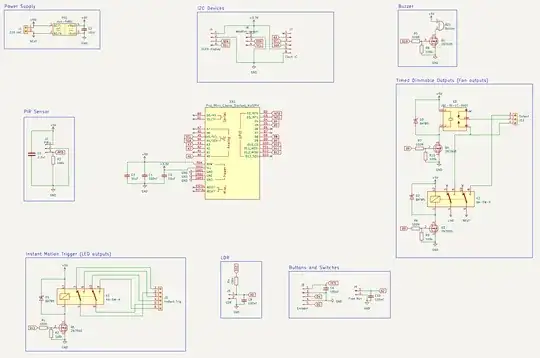

Schematic: schematic

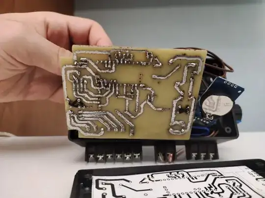

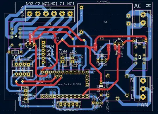

PCB (some mistakes were fixed later): enter image description here

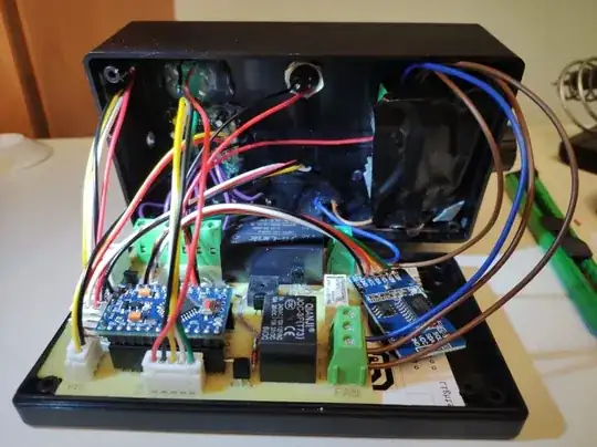

Real images:

It sounds like over ambitious pull up resistors. They should total about 3K on each bus. I will take a SWAG and say the I2C driver fet is drawing to much current and heating up. When it does that its resistance increase thereby delivering less current. Get your resistors correct and I believe it will work just fine.
If you have freeze spray chill them and they will probably start working until they warm up.
If it was left on for any period of time it is possible you damaged one of the ICs which is no longer driving the bus properly. If you can check it with a scope. If not swat parts.
