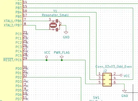

I want to build my first barebones AVR circuit.
I plan on NOT having a RESET button. For this reason, is it valid if I connect the ATMEGA's RESET pin to Vcc directly?
What I mean by this, is that in this scenario, I will not be using a pull-down resistor as well. Just straight to Vcc.
EDIT: This is a part of the schematic:

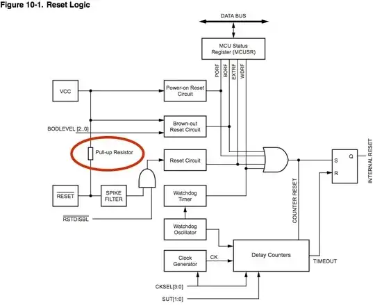

Regarding your comment "Thanks, but now I am not sure if this setup will work with Sparkfun's Pocket AVR Programmer.".
Looking at page 40 of the datasheet, a internal pull-up resistor is built into the MCU.

I updated the question with a pic. I am using ATMega328. I intend to program the chip using Sparkfun's AVR Programmer.
Then don't tie /RESET to VCC. The programming won't work. What are you doing? Trying to save one resistor? If you have J2 as a programming interface, then /RESET needs to be able to be pulled low to start the programming sequence. Either remove J2 altogether and program the chip in advance of going on the board, or use the pull-up resistor. Don't tie it to VCC.
