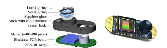

I want to use the ESP32-CAM as a sun sensor, the problem is that I would need to remove the lenses in order to put a membrane with a pinhole (like it's illustrated in the image) upon the CMOS, but I want to know first, will this make unoperable the OV2640? I want it to be working fine without the lenses, the second image is an illustrative of what I want to do. Fig.1
Fig.2

Consider using the ESP32-CAM as is. Instead use a pin hole camera box. Put the ESP32-CAM inside the box pointing it at the image of the sun at the back of the box. This approach mitigates problems associated with exposing the sensor to the elements and direct exposure to sun light.
In order to measure azimuth and elevation, consider mounting the device such that it points directly up from the surface of the earth. And such that it is aligned to true North. Consider using an accelerometer to detect the device is normal to the surface of the earth. And a magnetometer to detect magnetic north. And a GPS receiver to detect the position on earth. Combine the GPS data with World Magnetic Model (WMM) data to correct for magnetic declination.
