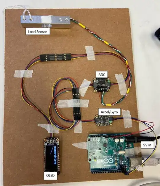

Both the OLED and the sensors successfully run independently while both are attached to the circuit. So -- I can get the OLED to display something while the sensors are attached to the circuit, and I can get the sensors to read into the serial monitor while the display is attached to the circuit. The problem arises when I try to have all of the parts called in the same script.
Here's a picture of the circuit: picture of an arduino connected to multiple small sensors, all taped to a cardboard tray
