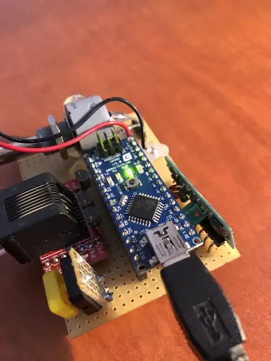

I am dealing with an Arduino Nano board rev 3.0 from Gravitech. There is a program inside that I'd like to download to a HEX file. Thus I can upload it to other Arduino Nano boards.
I'm a newbie with Arduino. Therefore I've read much documentation on the internet and I came to the point to use avrdude in the command line as Arduino IDE does not provide a feature to perform a download to an HEX file (as far as I've understood).
I've installed all the necessary software on my Mac OS Mojave (avrdude v7.0 using 'Mac Ports'). And after powering up and connecting the Arduino Nano board to a USB port of my Mac, I launched the following command line:
avrdude -p m328p -D -c arduino -P /dev/tty.usbserial-A9077L99 -U flash:r:programme_arduino.bin:r -v -x attempts=4
I obtain the classical message
stk500_recv(): programmer is not responding
I've noticed that the 'Rx' led and the 'L' led were blinking during the attempts.
From your perspective, do the options look good (-p -c ...)?
Arduino Nano Gravitech v3.0
