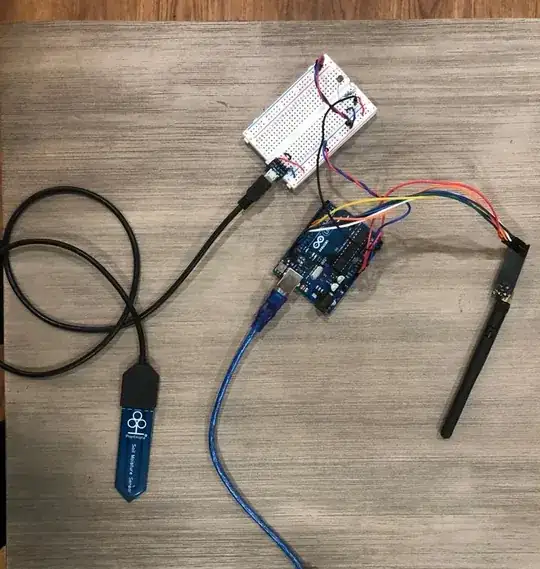

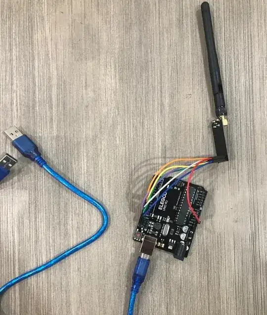

The actual build and components
Master ( transmitter ) takes inputs from the environment using a Ldr and hydrometer both water and light values and sends it to the slave microcontroller the receiver, wiring is correct. enter image description here
Slave ( receiver) processes the values from the transmitter and prints them in the serial monitor the messsage it recieves will depend on conditions such as light value thresholds and water value thresholds in simple terms if the light or water values exceed a certain value or are below a certain value it will send a different message for each situation.

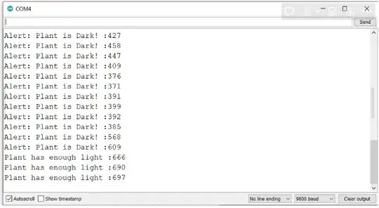

I figured the issue out.
  1. code was a mess but after troubleshooting it for a while the if statements didn't make sense and had no good flow to them plus too complicated. I had copied and pasted some code without making sense of it.
  2. It worked when I focused on one component like @jstola said. The photoresistor only and so the main thing is to add the conditional then turn string into a byte message and then void loop sends byte message to receiver arduino. Then the next part there were symbols appearing in the serial monitor and that was weird. So I experimented with the char data type instead of string and worked. Also use chatgpt as well for some syntax help.
Now I have base to work from. So next is to tackle the hydrometer.

result:
Video
