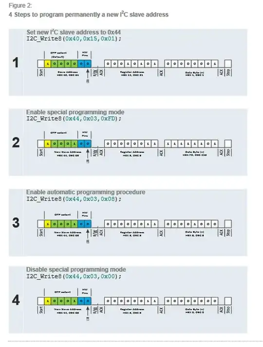

I know that normally the I2C addresses cannot be changed, but it looks like this one can:
Here's a snippet from the link above. It says the OTP bits can be programmed/burned (only once!). My understanding is that the I2C address is saved in the OTP bits.
Program the OTP bits permanently:
  1. Write dec.253 into the OTP control register (dec.3) to enable the special programming mode
  2. Set the Burn bit (dec.8) in the OTP control register (dec.3) to enable automatic programming procedure
  3. Write dec.0 into the OTP control register (dec.3) to disable the special programming mode

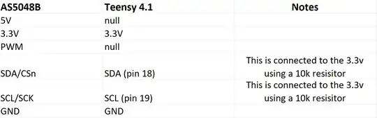

My wiring is as follows:
wiring

The device slave I2C address consists of the hardware setting on pins A1, A2 and upper MSBs programmable by the user. It is the setting of the MSBs, in addition to A1/A2 that I believe the OP is after.
The information provided by @Nick Gammon concerning A1 and A2 is correct, but does not consider the other 5 bits (the MSBs). It appears that you can, indeed, permanently set a new I2C slave address on the device.
You need to read the programming application note very carefully, but they explain how to burn those bits into the register....it seems straightforward and is really just four steps, but I suppose it can be a little daunting, e.g., "slave address consist of 5 programable bits (MSBs) and the hardware setting of Pins A1 and A2 I²C address <4> is by default not programmed and due to the inversion defined as '1'"
The application note gives an example of the 4 steps.... enter image description here
It may be the case that you already changed the I2C address default to 0x44 by following the instructions. [edited to add] Can you post the complete program [Arduino IDE code] that you used to try to change the I2C address?
