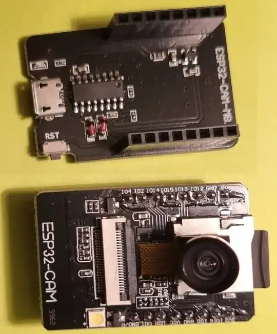

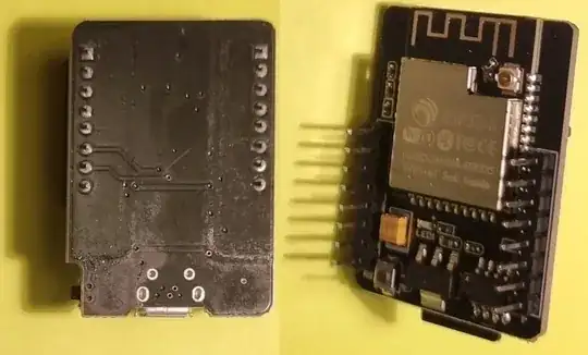

I bought a couple of ESP32CAMs from aliexpress... althought the listing shows them with two buttons, I got the ESP32-CAM-MB boards with just the reset button...
I have my computer set up to dual boot Windows and Linux so when I got an error in windows, I rebooted and installed the ESP32 boards for Arduino 2.1 and went ahead. I had to also install esptool and pyserial for it to work, but it ended up recognizing the port and every time I try to program it the flash flashes, but the programmer responds with
A fatal error occurred: Failed to connect to ESP32: Wrong boot mode detected (0xb)! The chip needs to be in download mode.

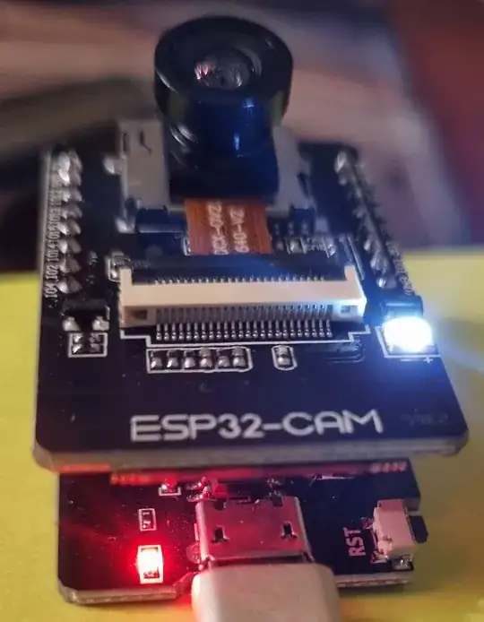

While making sure I included all the correct links and pictures in the question, I found the answer - if an SD card is inserted, the flashing cannot be performed.
Removing the SD card and resetting the ESP32 works. I now have a very bright flashing LED
