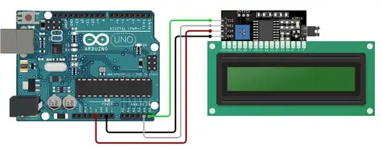

Note: The LCD screen that I'm using is connected to I2C protocol module. It has only 4 pins: SCL and SDA pins (connected to arduino), and 2 power pins (GND and VCC).
it should look like this when connected to a regular arduino uno: Figure 1: Arduino UNO with I2C LCD displaay
What would the circuit look like if I desire to use voltage divider?
