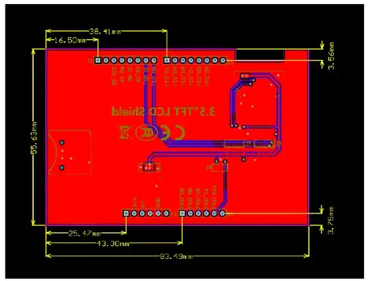

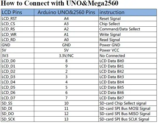

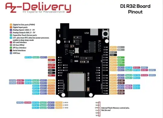

I've bought an ESP32 board from here and a 3.5" TFT Screen from here. The ESP32 board has an UNO type layout so I thought it would work with the screen which is designed to plug in and play with Arduino UNOs.
However upon plugging the board and shield together (they fit perfectly, each pin goes in a corresponding slot), loading one of the example scripts (provided on the 3.5" Screen .rar download on the page), set Arduino to use ESP32 Development Board on COM3 (my usual settings for the ESP32) and uploading the code I just get a white screen on the TFT.
Is there some accommodation that I have to make because my board is not an UNO but instead a ESP32, i.e. is the pin layout different so maybe I'll need to wire this manually?
I've included the pin out diagrams below:
TFT shield pinout TFT shield pinout instructions ESP32 pinout
