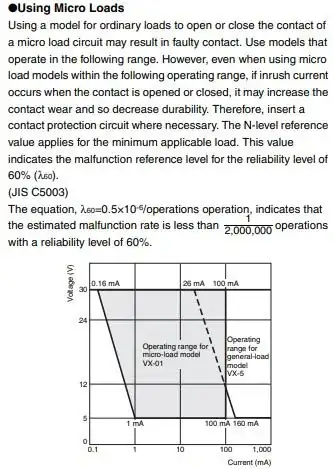

In the datasheet for the Omron VX series, I came across a diagram:
Operating range of VX
which prompted me to measure the current through the switch when pressed, which was only about 0.3mA. Since the digital pin voltage of the Arduino Micro is 5V, this state is not within the normal operating range shown in the diagram.
Could this be the reason for the poor contact of my microswitch? If so, how can I increase the current through the switch to bring it within the normal operating range? Would adjusting the pull-up resistor (using an external pull-up resistor instead of the Arduino's built-in pull-up resistor) be a feasible solution?
