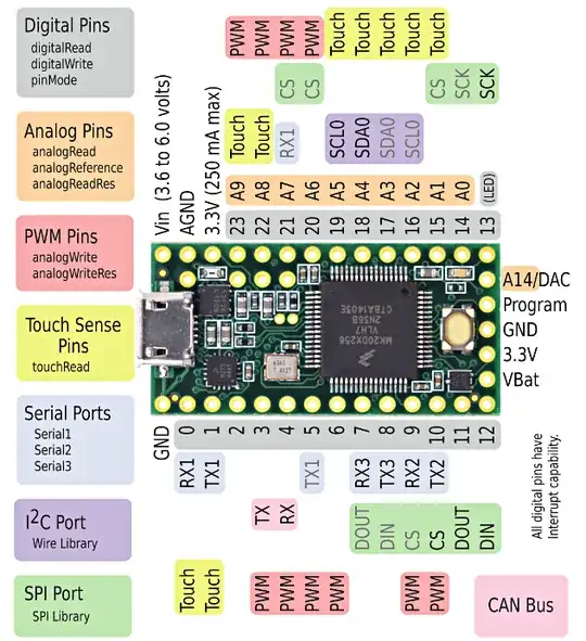

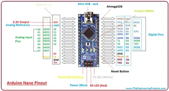

If you want further infos here is the pinmap for you : arduino nano pinout teesny 3.2 pinmap
