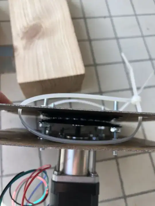

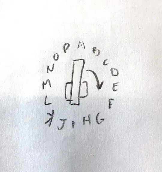

I am in the process of creating a system in which I want an object to turn on a plate and to show a letter depending on the angle of the rotation. The object is quite heavy hence the rotation should be quite slow, this is why I took a Planetary Gearbox NEMA Stepper.

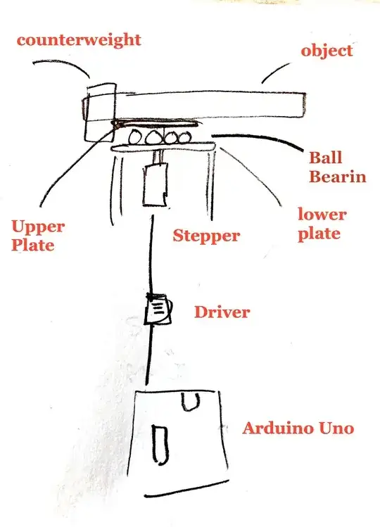

My system consists in:

I can't seem to understand how torque works within this system and how to minimise the stress I put on the motor. My hypothesis is that since the system is at equilibrium and the friction is minimised due to the ball bearing, there should be no need for a lot of power from the motor, and that this motor should suffice.

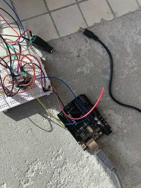

  • Not good enough electricity supply to the motor.

There is no one best speed. This depends on your requirements, the motor torque with the supplied power and driver and the rotational inertia of the object on the motor axis. You can measure the rotational inertia and set yourself a value for the acceleration (even if you don't write the program for acceleration, it will accelerate on the first steps), that you want to have. Then you can check, if your motor has enough torque for this.
Speaking about the motor: Check the ratings of the motor. A good supplier should also give you information on how much torque your motor has at specific currents. Then check if your driver can handle the current (these small stick drivers often cannot handle much current, like 1 or 2A max). These drivers also have a small potentiometer on board, which controls the motor current. Your supplier should also provide information on how to set it correctly (by checking the voltage on one of the pins). You can even find information about this online, when you search for your type of driver. Setting this wrong can lead to either an underperforming motor or the motor overheating. So when setting the motor current with the potentiometer, check the motor temperature afterwards while it is running. Every motor has its own temperature rating, but I would suggest not letting it get too hot to touch.
