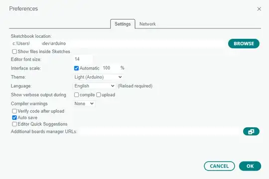

Here's what I see in preferences -- don't see a location for user libraries:
arduino preferences
The best location will be your sketchbook location + a folder named libraries.
For example, in my case my sketchbook location is :
c:\users\<username>\dev\arduino
so my library folder should be:
c:\users\<username>\dev\arduino\libraries
