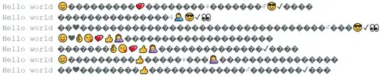

However, the Serial Monitor sometimes displays emojis and sometimes not. It varies from line to line like so:
Hello world �����������������♀�������‍♂️✔����
Hello world ���������������‍♀️‍♂️✔
Hello world ��❤���������������������������������♂���✔
Hello world ❤‍�������‍�������������
Hello world �������‍♀️��������������✔����
Hello world ��������������♀��������️�����������
Hello world ��❤����������‍�����������♂�������✔���
Again, there's how it looks like on my Windows 10 machine:
Screenshot of garbage output
I verified that it's not a mistake in the baud rate. Both, Arduino and PC are set to 9600.

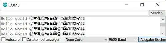

In Arduino IDE 1, the output is not colorful and some emojis are not rendered at all, but the result is much more consistent:
Screenshot of output in Arduino IDE 1
