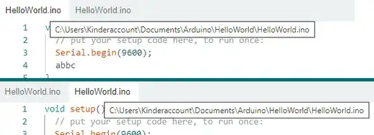

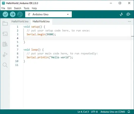

For a reason unknown to me, Arduino IDE 2.0.3 opens two tabs with the same name for this sketch. I'm not able to reproduce how to get into this situation.
Changes in one tab immediately changes the other tab as well.
How can I get rid of the second tab?
Duplicate tab

The tooltip which shows the full file name is identical on both files:
Identical tooltips
  • Press F1,
  • Type: View: Reset Workbench Layout into the Command Palette,
  • Press Enter,
  • IDE reloads.
If it does not help, get the layout data from the logs.
  • Open the DevTools with Ctrl/⌘+Alt+I built-in command,
  • Open the Console if it's not opened with Esc,
  • Right-click in the console and Save as...,
  • Share the data with the devs.
For example:
{"version":5,"mainPanel":{"main":{"type":"tab-area","widgets":[{"constructionOptions":{"factoryId":"code-editor-opener","options":{"counter":0,"kind":"navigatable","uri": ...
