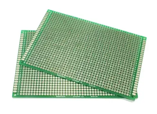

Here are some double-sided prototyping boards (or "perf boards") to look into once you get to this stage: (Ebay search for "double sided pcb") http://www.ebay.com/sch/i.html?_from=R40&ghostText=&_sacat=0&_nkw=double+sided+pcb&rt=nc&LH_BIN=1 -- get the ones with all the little holes in them. You can put the whole thing in a plastic case if you want too. You can permanently solder an Arduino (esp. the Nanos or Micros more easily) to one of these perf boards.
Here's another example of double-sized perf board. (image source: http://www.elecfreaks.com/store/doublesided-protoboard-8cm-x-12cm-p-410.html) Here's an example of double-sized perf board
