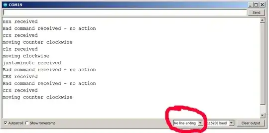

In addition to the good responses you have already received, I offer this.
For the Arduino, know the differences between String string and char arrays - there is much on this e.g., https://forum.arduino.cc/t/string-vs-string-vs-char-arrays-correct-approach/537468 . Many do not want to deal with the vagaries of String, but their use can be convenient.
Run this code:
String readstring = "xxx";
void setup() { Serial.begin(115200); }
void loop() { if (Serial.available()) { readstring = Serial.readStringUntil('/n'); Serial.print(readstring); Serial.println(" received"); if (readstring.equals("crx")) { // move counter clockwise Serial.println("moving counter clockwise"); // counterclockwise() <-- your function } else if (readstring.equals("clx") ) { // move clockwise Serial.println("moving clockwise"); // clockwise() <-- your function } else { // bad command Serial.println("Bad command received - no action"); // badcommand() <-- your function } } }
If you add functions for the stepper, it may do what you want within a limited context and with using the Arduino serial monitor for input. Take a look at the output.
Note that the serial monitor is set to "no line ending". The terminating character '/n' is provide by your input in the serial monitor. It will do what you want, but again, many advise you stay away from String.
