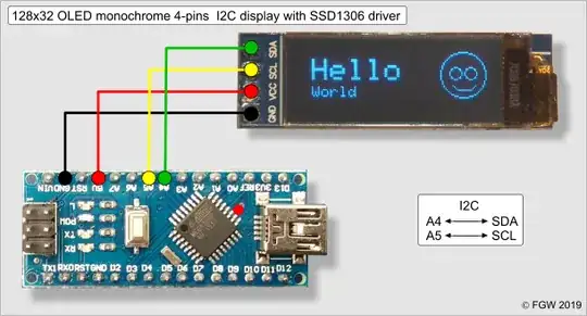

I'm currently trying to get this SSD1306 0.91" OLED screen with an Arduino Nano with the U8G2 library (as per seller's guide), and in any code I run, as soon as a delay() is executed, the screen goes blank and doesn't show any further text or image.
What is the possible cause?
Wiring
Code

Troubleshooting executed
  1. I used a different Arduino Nano, and result was the same.
  2. I'm using a 5V 2A power supply for the entire circuit.
  3. I tried different U8G2 example sketches, with the same result (only working if no delay()).
  4. I tried using another OLED module of the same specs, and result is the same.
  5. I've tried to use Adafruit SSD1306 library, and screen doesn't show anything.
