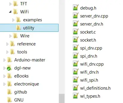

Your second problem (the real one I would say) is due to to the structure of WiFi library: enter image description here
Indeed, as you can see above, it has a utility subdirectory that contains additional source code that cannot be found by arduino-cmake, as by default it searches for source code files only at first level directory.
How to solve it? Just tell arduino-cmake to do a recursive search for the WiFi library; in your CMakeLists.txt, ensure you add the following line:
set(WiFi_RECURSE True)

The added set(WiFi_RECURSE True) line just tells arduino-cmake that, for WiFi library, it should recurse through subdirectories when looking for source code.
I have checked it with "Unix Makefiles" (not "MinGW Makefiles" but I guess that won't make any difference) and it worked fine.
