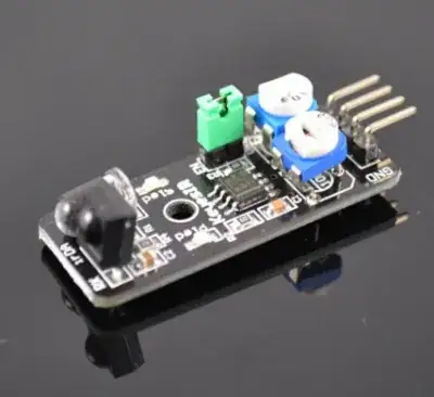

We've got an Arduino KY-032 obstacle avoidance sensor, and have spent a decent time searching and researching to find a detailed data sheet/manual to figure out how it works; but there aren't any detailed information on the module.
Arduino KY-032
One of the few instructions here says that the potentiometers on the chip are used to adjust the distance, but I've tried all different settings and the maximum I can get is 10 centimeters. I've tried different surfaces with different reflectivity levels, but it doesn't really differ much.
Any idea how to increase the distance on this? Anything to do with the enable jumper?

The wizecode page has some nice info. However the R5 pot (near the EN jumper) does not change the duty cycle but directly the current to the IR LED - still affects the brightness though. Too much current seems to trigger false positives - depends on your additional optical shielding. I put some black heat shrink tubing over the sensor - with a hole punched in for the sensor to see though. Also the R6 pot does not really "fine tune" the frequency, more like "coarse tune" - even a small nudge can detune by a kHz, greatly reducing the sensitivity.
If you use the EN jumper, a suddenly appearing object gives a short pulse, but then the disturbance signal suppression kicks in turns sensitivity down and 'unsees' the object. Also slowly appearing objects are not recognized for that reason. Only very near objects (a few cm) give a strong enough signal to overcome that sensitivity attenuation.
What I found somewhat irritating: Setting EN to LOW lets the IR LED steady on instead of off, which I would have expected. That might irritate the sensor more than necessary. Also draws more power (maybe even a lot, depending on R5 current setting).
Funny enough, you can get a somewhat analog behaviour from this sensor if you measure how long it takes from activating the EN pin to the sensor output getting low. The nearer the object is, the faster it reacts. Near objects take ~190us, farther objects more than 400us. Not nearly a linear behaviour though. Also depends on distance, size, angle, IR reflectivity and IR LED power. However it can detect a person in more than 1m distance.
DrJones
The IR sensor module incorporates an internal 38KHz bandpass filter. The pot near the GND pin fine tunes the frequency of that signal, which is used to illuminate the IR LED.
The other pot adjusts the duty cycle of the signal. This controls the brightness of the IR LED. Both adjustments effect the sensitivity and range of the device.
To achieve maximum sensitivity, it is absolutely necessary to use the 'EN' or 'Enable' pin. When used correctly, however, additional optical shielding of the IR LED is required. This can be done with a small cardboard tube commonly used as packing material or any of a variety of other materials.
If the Enable function is not used, the jumper must be installed on the board. The Enable pin cannot be used if the jumper is in place.
For more information, see: http://irsensor.wizecode.com/

Check This: http://irsensor.wizecode.com/
When the GREEN JUMPER is installed on the board (see picture), the IR LED will flicker continuously at 38kHz. If the Enable (EN) function will not be used, the jumper must be installed . When the jumper is removed, pin 4 of the 555 timer is held LOW (RESET) by R3, a 22K pull-down resistor. Then, if a HIGH condition is applied to the EN pin, the reset condition will be relieved and the 555 timer will begin to oscillate. The Enable function cannot be used if the GREEN JUMPER is in place. You must remove the jumper on the board in order to use the EN (Enable) pin.
