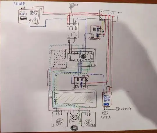

i do some project. There is DS18B20, 3 mosfet modules, 1 relay, display 1602, buzzer... I built it on bread board, everything worked. Now i soldered it: arduino works, display works but DS18B20 doesn't return temperature.
I tried to solder thermometer over again - no result. Then i glanced at my sketch and tried to remove some code in loop and setup. I understood that DS18B20 works only if in setup function no pinMode(...) for other modules. It's odd!
This is part of my code:

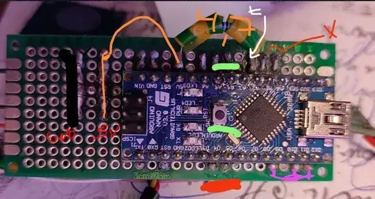

UPDATE #1 I figured out that if i use ports A0 and A1, i get message "error" for this sketch:
#include <microDS18B20.h>
MicroDS18B20<A2> sensor;
  Serial.begin(9600);
  sensor.requestTemp();
delay(1000);
if (sensor.readTemp()) Serial.println(sensor.getTemp()); else Serial.println("error"); }

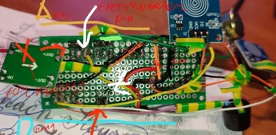

And more. I get this message "error" every time without any connected modules. After some connects and disconnects of mosfet module to pins A0, A1, D5, D6. No temperature at all! enter image description here enter image description here enter image description here

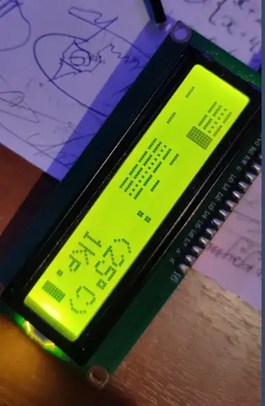

Update #2 I think it's died.
My main sketch (it worked yesterday) now doesn't work at all. But then i try some reboots and it works but not properly... So, if it works, i can see my menu on display but it's ierogliphs sometimes. also sometimes buttons stop to work...
Is aruino dead? enter image description here
