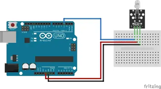

I connected the module according to the diagram: enter image description here

When I ran the Sketch on my Uno and viewed the module through my camera phone, I did not see the module blinking. My assumption is that this is not working for some reason. Any ideas why?
Also, I'm measuring about 4.5 volts between GND and the middle pin. That seems right. When I measure GND and the signal out pin, I get a steady 0.64 volts. Shouldn't that be toggling between 0 and some number?

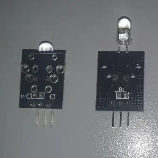

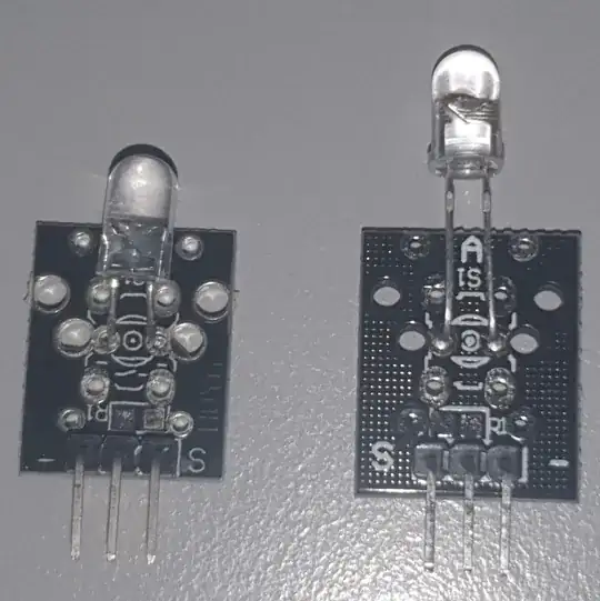

UPDATE per @jsotola's comment:
enter image description hereenter image description hereenter image description here
