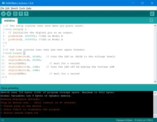

It worked fine, but now every time I plug it to the USB port on my computer, Windows detects it as a Keyboard and starts typing what I programmed it to type.
Arduino IDE can't reprogram it. When it says "Plug in device now", I do it, but it immediately acts like a Keyboard, not like a programmable ATTiny85.
Arduino IDE
Note: Image shows the console output. Code is just a simple blinker.
Is there any way to save this board? I just want to upload another sketch to it. Maybe some way to rewrite the bootloader or to erase the flash memory entirely.

If you can't access the bootloader using USB your remaining option is ISP/ICSP (In-Circuit Serial Programming). I have that digispark board and I have never been able to program it using Arduino's IDE/USB. However, since then I always use both an USBasp programmer and the AVRDUDESS programming tool. With them you can eassily program the controller (they have never failed me). Connect the SPI, +5V, GND and RESET connectors from the ATTINY85 to the programmer, compile the code, program the binaries with AVRDUDESS and voila.
