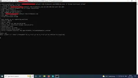

I have data on firebase rtdb, which i want to listen in my nodemcu. I know there are libraries available like this one which provides listeners, but i want to do it using REST API streaming as mentioned in firebase documentation for rest api streaming. So far i have successfully tested with curl on cmd as shown
My curl command is:
curl -v https://<name of rtdb>.firebaseio.com/SD0001/Up.json -H "Accept:text/event-stream"
