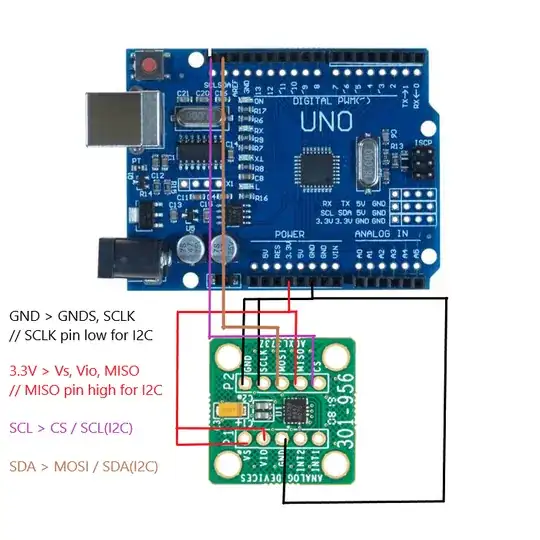

When I run the code, I am getting incorrect values which are probably not even acceleration data. I am thinking it might be a wiring problem, I attached circuit diagram below. This is my first Arduino project, and I couldn't find any other applications with the sensor I am using so any help would be much appreciated. Thanks in advance.

Circuit Diagram :
Circuit Diagram

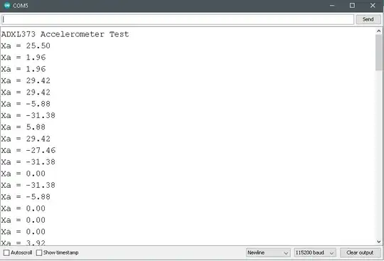

Results from Serial Monitor (in m/s^2) :
Serial Monitor

Edit: Addressing the edited code from the OP:
I modified the code according to your suggestions. But I am still getting incorrect values from serial monitor.
What I see in your post is very small values, around ±3 LSBs of the sensor. This could very well be sensor noise. But then, there is the occasional larger value. Interestingly, those larger values seem to be very close to ±16 LSBs, hinting at some kind of communication problem.
