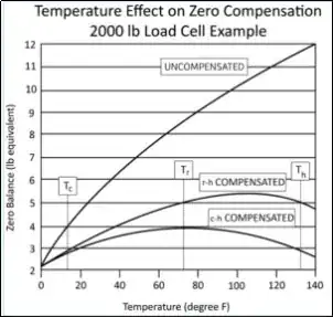

Consider a change in temperature either the cause or partially the cause for weight drift. This supplier web page talks about load cell temperature compensation. There they consider a 2000lb load cell. Their chart infers a 20 degree Fahrenheit change can cause an temperature uncompensated load cell to change about 1.5lb.
