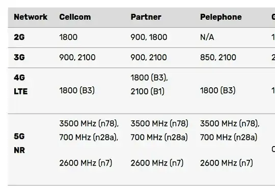

SEE PELEPHONE: Carrier support - "PELEPHONE"

Your mobile network provider does not provide a 2G (GPRS / GSM) network.
2G is graduallly being phased out around the globe, so switching to an LTE modem is really the way forward.
If you still want to use the SIM800L then you need a network provider that gives 2G services. Fortunately the SIM800L is a "quad band" modem, so it will work with pretty much any 2G provider (it works on 850/900/1800/1900MHz, hence the "quad" of "quad band").
