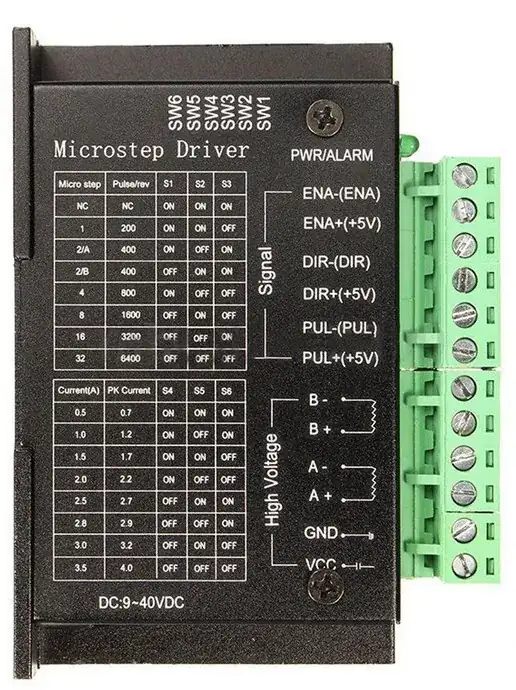

The problem is that "two pins" and "last two pins" do not tell me anything about which pins go where on the motor driver. I am using a DM320T stepper driver
Can anybody tell me what "pin1 pin2 pin3 pin4" actually correspond to?

The standard Stepper library does not support stepper drivers, which only have a step (in this case labels "PUL" for pulse) and a direction pin (labeled "DIR"). So you need to use a different library. I suggest using the Accelstepper library, which is also more capable than the standard Stepper library. Then you can define the AccelStepper object like this:
AccelStepper stepper(AccelStepper::DRIVER, STEPPER_DIR_PIN, STEPPER_STEP_PIN);
About the connections: The shown driver is meant to be connected with twisted wire pairs, so in this case one wire for signal and the other for ground or 5V. Look at the documentation for your stepper driver. There you should be able to find a wiring diagram.
