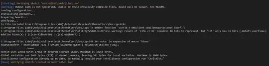

And the error message:
[Starting] Verifying sketch 'controller\controller.ino'
[Warning] Output path is not specified. Unable to reuse previously compiled files. Build will be slower. See README.
Loading configuration...
Initialising packages...
Preparing boards...
Verifying...
In file included from C:\Program Files (x86)\Arduino\libraries\Ethernet\src\Dns.cpp:8:0:
C:\Program Files (x86)\Arduino\libraries\Ethernet\src\Dns.cpp: In member function 'uint16_t DNSClient::BuildRequest(const char*)':
C:\Program Files (x86)\Arduino\libraries\Ethernet\src\utility/w5100.h:457:25: warning: result of '(256 << 8)' requires 18 bits to represent, but 'int' only has 16 bits [-Wshift-overflow=]
#define htons(x) ( (((x)<<8)&0xFF00) | (((x)>>8)&0xFF) )
C:\Program Files (x86)\Arduino\libraries\Ethernet\src\Dns.cpp:164:18: note: in expansion of macro 'htons'
twoByteBuffer = htons(QUERY_FLAG | OPCODE_STANDARD_QUERY | RECURSION_DESIRED_FLAG);
Sketch uses 22574 bytes (69%) of program storage space. Maximum is 32256 bytes.
Global variables use 1467 bytes (71%) of dynamic memory, leaving 581 bytes for local variables. Maximum is 2048 bytes.
IntelliSense configuration already up to date. To manually rebuild your IntelliSense configuration run "Ctrl+Alt+I"
[Done] Verifying sketch 'controller\controller.ino'

Everything is alright. There is no compiler error and your sketch is ready to upload.
The compiler warning "result of '(256 << 8)' requires 18 bits to represent, but 'int' only has 16 bits" from the Ethernet library source code is nothing you have to worry about.
