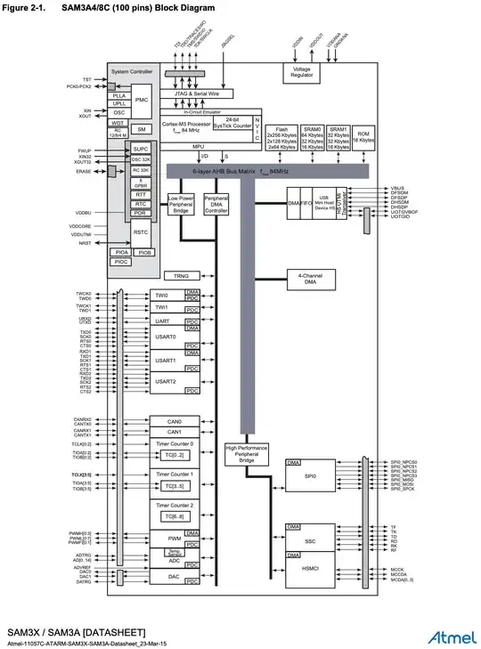

  • The SAM3x datasheet block diagrams show a unified bus (i.e. Von Neumann architecture (not Harvard architecture like the AVR boards))
    SAM3X block diagram

Yes, the Arduino Due uses a flat memory model with a single address space for Flash and RAM. Therefore all constant data sits in flash and does not need to be copied to RAM at startup, like the AVR-based arduinos do. The progmem stuff for the AVR-based CPUs is required because they need to use different instructions to read data from flash than from RAM. This is no longer the case on the Due (nor most other 32-bit MCUs, such as the ESP32), and a string address in an instruction works just the same whether its in RAM or in Flash (as long as it's not written to, of course).
The F() macro is available for convenience, so that you can more easily write code that works for all Arduino boards. On the Due, it is basically implemented as no-op.
When you're working on the memory model of the Due, I might point to this question, showing that there's a bug in the memory management implementation of the Due, allowing unlimited memory allocation.
