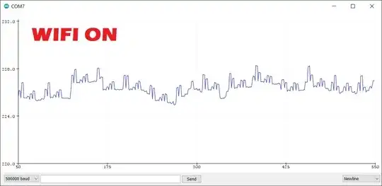

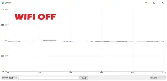

I'm using the ESP32's ADC1 (not ADC2, which conflicts with WiFi functionality) to capture some analog data received at IO36 (an ADC1 port).
As soon as I uncomment the WiFi.mode(WIFI_AP_STA) line (even when the WiFi.begin() line is still commented out), analog readings go crazy!

In general anything related to WiFi causes the ADC to get unstable. No matter which ESP32 board you use, you could simply serial plot any ADC1 channel before and after the WiFi initialization command, even with floating ADC1 pins you can see the difference.
Signal goes crazy even though there is a 100uF cap at ESP32 Power entrance
#include <WiFi.h>
float R = 0;
void setup() { Serial.begin(500000); // WiFi.mode(WIFI_AP_STA); // uncommenting this line analogread goes crazy, even while the following line is still commented out // WiFi.begin(); analogSetAttenuation(ADC_0db); }
void loop() { R = analogRead(36);
Serial.println(R/12.21); }
