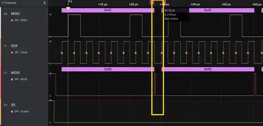

OK, the time between clock pulses is now 2 µs, however as I document here the time taken to execute an ISR like SPI_STC_vect is 2.625 µs, therefore it can't keep up with having to put the data there every 2 s.
You actually have slightly more time than 2 µs because the critical time is the time between the end of the first byte (which is when the ISR is called) and the time before the start of the second byte, which is when the master will start sampling your response.
See screenshot below with the critical time boxed in yellow.
SPI timing screenshot
That time is 2.45 µs and the ISR takes 2.625 µs. Now some of that is the ISR epilogue which won't really matter that much, but you can see that things are tight. It's hard to know exactly at what point the processor starts calling the ISR after the last bit arrives, and the length of the instruction it is currently executing could be an influencing factor.
