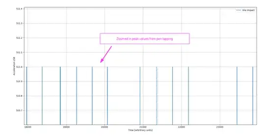

During some tests I was swinging the accelerometer with my hand, and tapping it directly with a pen, which gives a momentary high impact. The swinging values are represented well and look credible to me, however the pen tapping values seem to be cut off at precisely 511 LSB, see graphs. That seems incorrect. So why is that?

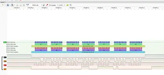

enter image description here enter image description here I also had a look whether the SPI transfers are okay. The image shows one multibyte read, consisting of a command byte on the far left, and then 6 read bytes after that. Nothing out of the ordinary there. enter image description here

I found the answer. Turns out the datasheet of the ADXL375 is wrong, and the user can actually change the range themselves (even though the datasheet says you can't). In my case, the range was unintentionally set to 25 g (instead of 200 g). See below the full explanation by bvn123 - which was posted in 2017, yet Analog Devices has still not updated the datasheet.
I use ADXL345 and ADXL375 under a uC software, which was written for ADXL345.
The Datasheet for ADXL345 says about ±2g/±4g/±8g/±16g ranges and corresponding to these ranges 10/11/12/13bits resolutions.
The Datasheet for ADXL375 shows only one range ±200g and 13bits resolution. .
Inspite of the ADXL375 Datasheet's info, that Register 0x31 only state for bits D3:D2:D1:D0 is 1n11 (D3 is the Full resolution bit, D1:D0 are the Range bits), the ADXL375 reacts for D1:D0 and D3 change in the Register 0x31 the same way, as the ADXL345,
So, in reality ADXL375 also provides 4 ranges (±25g/±50g/±100g/±200g).
