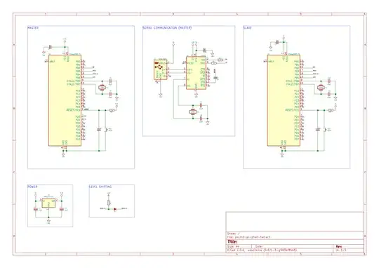

Here is my schematic. I am using bare ATmega328 chips rather than Arduinos, but the situation would be the same if I were using a 5V Arduino Nano and a 3.3V Arduino Nano.
(Except the slave would run at 16MHz instead of 20MHz.)
schematic

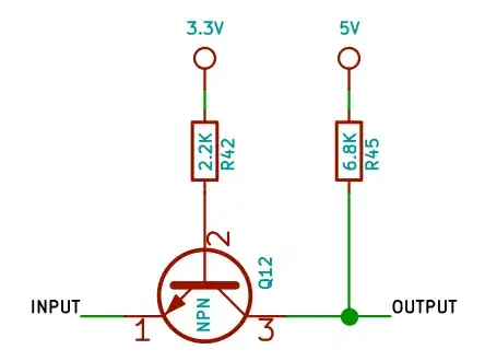

I also tried with the following level shifter on the MOSI, SCK and SS lines:
active level shifter

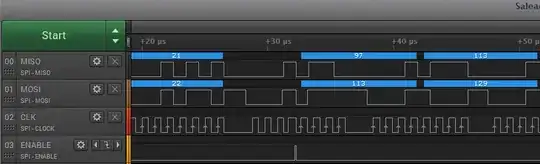

EDIT: I connected two Arduino Nanos together and got different - but still erroneous - behaviour.
The SS pin, despite being set to LOW at the start of the program and never touched again - goes briefly high every so often, corrupting the communication:
SS pin logic analysis
(If I use a different pin for slave select, I get the same behavior.)
