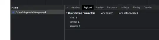

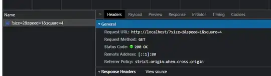

It is unclear what you are actually asking.
I ran a python minimal web server in the same folder as index.html.
Here is the trace from the server.
C:\Users\qwerty\Desktop2\MinimalExamples-main\22-1-25_query_parameters_submitButton\data>py3 -m http.server 80
Serving HTTP on :: port 80 (http://[::]:80/) ...
::1 - - [27/Jan/2022 15:43:23] "GET / HTTP/1.1" 200 -
::1 - - [27/Jan/2022 15:43:24] code 404, message File not found
::1 - - [27/Jan/2022 15:43:24] "GET /favicon.ico HTTP/1.1" 404 -
::1 - - [27/Jan/2022 15:43:25] "GET /selection.html HTTP/1.1" 200 -
::1 - - [27/Jan/2022 15:43:32] "GET /?size=2&speed=1&circle=3 HTTP/1.1" 200 -
::1 - - [27/Jan/2022 15:43:34] code 404, message File not found
::1 - - [27/Jan/2022 15:43:34] "GET /notMinimal.html HTTP/1.1" 404 -
::1 - - [27/Jan/2022 15:43:39] "GET /?size=1&speed=2&circle=3 HTTP/1.1" 200 -
::1 - - [27/Jan/2022 15:45:07] "GET /?size=1&speed=2&square=4 HTTP/1.1" 200 -
::1 - - [27/Jan/2022 15:52:46] code 404, message File not found
::1 - - [27/Jan/2022 15:52:46] "GET /notMinimal.html HTTP/1.1" 404 -
::1 - - [27/Jan/2022 15:53:02] "GET /?size=2&speed=1&square=4 HTTP/1.1" 200 -
This is what index.html is called with. The data is available to index.html. You only have to parse it from the URL.
