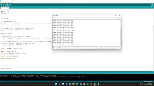

Hi! I require your help regarding a problem I’m encountering. I am trying to measure wind speed using Hall sensor, Neodymium magnet & below mentioned code. But I only get “0” value for both RPM & KPH values. Can you help me to solve this?

rpmilli = revolutions/(millis()-timeold);
All variables in this line are of type int, so this is an integer division. When the time delta in ms is larger than the number of revolutions it counted, this always returns 0. You need to change this to:
rpmilli = ((float)revolutions)/(millis()-timeold);
and change rpmilli to float.
