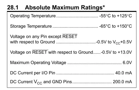

I'm going to steal my answer from when I answered this question on the last arduino SE attempt.
This is a bit complex. Basically, there are a number of limiting factors:
The IO lines from the microcontroller (i.e. the analog and digital pins) have both an aggregate (e.g. total) current limit, and an per-pin limit:
From the ATmega328P datasheet.

  • The absolute maximum for any single IO pin is 40 mA (this is the maximum. You should never actually pull a full 40 mA from a pin. Basically, it's the threshold at which Atmel can no longer guarantee the chip won't be damaged. You should always ensure you're safely below this current limit.)
  • The total current from all the IO pins together is 200 mA max
