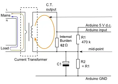

Using an Arduino Nano and a current transformer (CT), I'm trying to sense the current flowing through a 120 V 60 Hz line.
Circuit
CT outputs 0-1 V according to its specifications. This output is biased AREF/2 = 2.5 V.
Enter image description here

Time taken for an analogRead was measured to be 110 microseconds for my setup and there are 1026 samples between the waveform peaks. That means there will be about 9 peaks in 1 second, although I would expect 60 peaks since we are sensing a 60 Hz line. What do you make out of this? There's a capacitor, C1, in the circuit, would it have anything to do with this?
Are these analogRead values suitable to be used to calculate the RMS voltage, and hence the RMS current passing through the wire being sensed? The final goal of this is to calculate the power usage after determining the RMS current flowing through the wire.

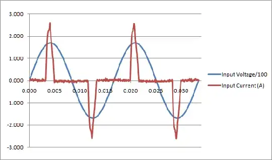

For a PC or laptop power supply that's quite a common current waveform.
Without effective Power Factor Correction the current signal shown below would be quite typical (source: http://www.nlvocables.com/blog/?p=300)
You will need to calculate RMS values and it would be wise to filter the signal.

if you are measuring a resistive load I would say that the burden resistor you have chosen is wrong, there are some cheap CT's on ebay (SCT-013-xxx) that have versions with and without the burden resistors, these work well for their price but you must read the datasheet. the SCT-013-000 requires a 20R resistor to get 1V out with a 100A load, if this resistor is wrong you can get a severely distorted waveform when measuring higher currents (similar to those you have provided), you would expect the signal to distort more the lower the burden resistor value but this is not the case with CT's.
Ian
