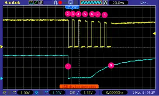

Desired behaviour:
  1. Go to IDLE sleep mode.
  2. When PB2 (blue trace) goes low wake up and give a 10 ms HIGH on PB1 pulling a pull-up low (yellow trace on Figure 1).
  3. Go to 1.
What I get:
Oscilloscope view.
Figure 1. (1) The input triggers, (2) the CPU wakes from sleep, (3) the CPU goes back to sleep and wakes up repeatedly until (9) the input goes high again.
I want one 10 ms low pulse and then go back to sleep until the next negative going edge on PB2 regardless of how long PB2 is held low.
Even though I set MCUCR to falling edge of INT0 the device seems to wake repeatedly when PB2 is held low. My code below attempts to solve this by switching to rising edge interrupt if the input is low and falling edge interrupt if the input is high. The result is shown in Figure 1.

The Arduino core configures a timer to deliver a periodic interrupt. This interrupt is used to implement millis(), delay(), etc. Your code assumes the external interrupt is the only one the microcontroller can receive. I guess the timer interrupts may be the cause of the observed behavior.
I suggest configuring the interrupt for falling edges and leaving it always on. The ISR can take care of starting the pulse, and setting a flag to let the main loop know the pulse is active. The main loop can then stop the pulse when it has been on for long enough:

Note that the little nap in the code above can be interrupted by either the external interrupt or the timer interrupt.
