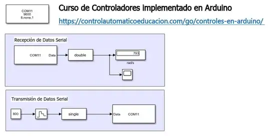

I am working on servo motors control through serial communication protocol, I am sending data from Simulink to arduino and vice versa, The problem I am getting is that once I open Simulink Servo motors start turning while no command is sent or received from both, I tought that Simulink is initializing (reseting) arduino, so I decided to add a capacitor between Gnd & reset (I also tried with a resistor between 5v & reset), It actually works when I try to use Arduino IDE, Arduino is not reseting, but When i use it with Simulink it doesn't make change, Servo motors still turning randomly (I think that when I start or close simulation, Servo Are going to their initial position, I am not sure). I tried to add initial Position in Setup() function but in vain, It doesn't make sens! I tried using different arduino cards (MEGA, ESP32...Etc.) but in vain.
Does anyone have an idea about how to figure out this problem? Here is Simulink control code : & Arduino code :
