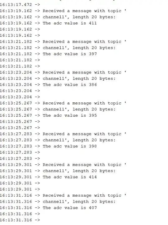

I am trying to determine why my Arduino MKR NB 1500 code keeps crashing when the serial monitor is open and I look for data. I removed the string functions to prevent it from causing memory fragmentation, but does not seems to have helped.

The output looks as follows when it gets stuck:enter image description here
