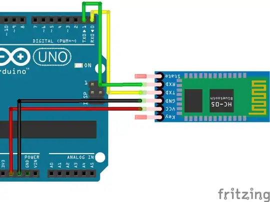

I am trying to link the Bluetooth module to my arduino UNO in order to wirelessly program a robot. The only issue that I am having is that the bluetooth module does not seem to pick up the arduino.
Here is how the bluetooth module is wired up to my arduino: enter image description here

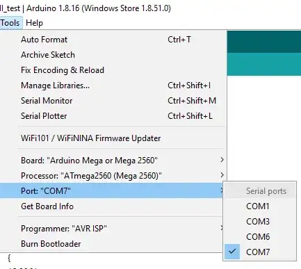

The bluetooth module is paired to my PC via a bluetooth dongle. I know that the bluetooth module is working on port COM7. The LED then on the bluetooth module blinks quickly. After this I set the port to the correct port that the bluetooth module uses:
One thing that I found strange was that the name of the arduino board does not come up just like when I use a USB to upload the program.

(The following situation occurs for all 3 samples of code I copied from online). When I set the port to COM7 and then click upload to the board, the IDE says "Uploading" and the LED begins to blink more slowly just like as I was mentioning before with the serial monitor. After a while eventually the following error messages came up:
avrdude: stk500v2_ReceiveMessage(): timeout
avrdude: stk500v2_getsync(): timeout communicating with programmer
I looked online for answers. The internet suggested to use a larger baud rate so I switched it from 9600 to 57600 and also at the same time switch from Newline to Both NL and CR. Still nothing happened and I got the following error message. One final suggestion I saw on the internet was to put a resistor divider/voltage divider across the RX pin (I haven't done this as I don't see how this could make a difference, I could be wrong about it though and it could make the whole difference).

The Bluetooth range is small so the robot can't be far from the computer for upload.
To solve the reset for the Bluetooth you could add a reset button on the robot and use it while avrdude attempts to upload the sketch. Baud rate on HC-05 must be set to 115200 baud.
As an alternative you could have USB connector on the robot. You can use a short USB extension cable as internal cable from the USB connector of the Arduino to the outer shell of the robot.
